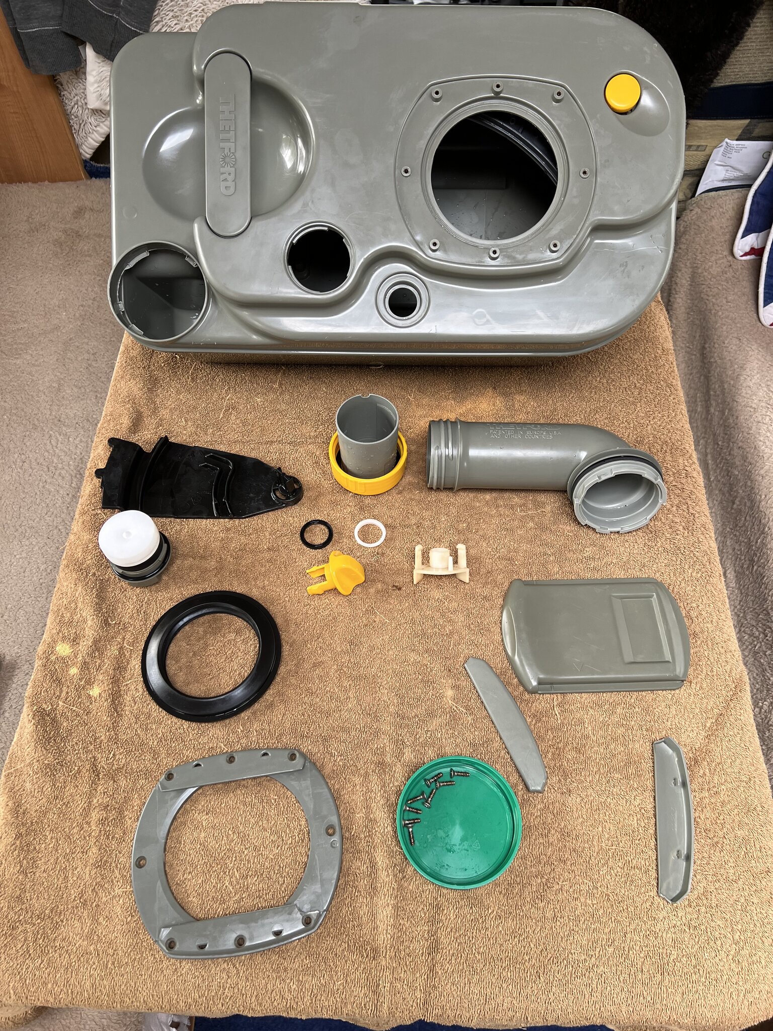

View attachment 789063View attachment 789064
