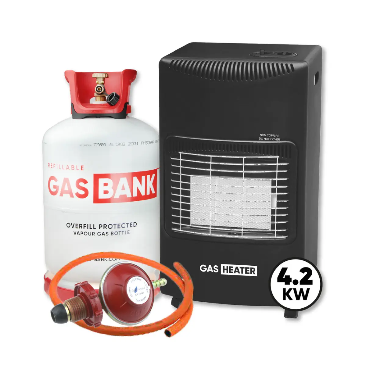

As we have been thinking about Gas Safety .Anyone see any problem with this set up ?
Two things. Not supposed to used propane indoors. No jubilee clips?
The GasBank site only talks of LPG. I think that's predominantly propane. Certainly in the UK.
It's a vapour gas bottle, not lpg?
Here’s a clue
We actually refuse to sell refillable LPG cylinders to customers that want to use them indoors, especially in cabinet heaters.
Wrong pressure :unsure:
LPG from filling station is a mix of propane and butane. Don’t think propane is allowed for indoor use.
If its true that Propane Gas is not suitable for "indoor" use, then I am struggling to see how its OK to use in Motor Homes, after all that could also be classed as "indoor" use?:unsure:
I am sure many would have seen those large industrial Gas Blower heater's used to keep warehouses/building sites dry & warm, they run on Red Bottled Propane, same as most static caravans have red Propane bottles although they are normally stored outside the caravan.
I am dying to find out from Basildog what the correct answer is.
LES
No refill and regulator adapter in photo?
The regulator is a propane regulator for an exchange propane bottle & 37mb. For a cabinet heater it should be butane at 28mb.
The bottle is LPG which in the UK is 95% - 100% propane which you are not allowed to use indoors.

Your point is extremely valid and one many struggle to get their head round 😂
One difference might be the bottle storage. In a motorhome the bottle has to be stored in a room sealed locker with a drop vent to allow gas to escape. The pressure is reduced from propane at about 8.5bar (123psi) to mere millibars before it goes outside the locker. In a house the 8.5bar would be right next to the flame, a leak could be catastrophic. Butane bottles are at a much lower pressure of about 1 bar (15psi) and a much lower risk.
Spot on 👍
You would be surprised how many can’t understand that essentially the gas locker in a leisure vehicle is basically external.
So whilst Propane is perfectly safe to use indoors , Propane cylinders or tanks should NEVER be stored or used indoors.
Especially not in a cabinet heater .
From Calor website:
How much gas can I store?​
Here are our guidelines on how much gas you can store safely
For residential properties, you can store up to 30kg of butane (2 x 15kg gas bottles) indoors, for use in portable gas heaters for example.
Propane should always be stored outdoors; and in the case of fixed installations, propane should be sited outside. Calor stockists and commercial/industrial premises may use propane indoors on a temporary basis, for example whilst using a blowtorch, but the LPG should be stored outdoors and in accordance with the UKLPG Code of Practice No 7 "Storage of Full and Empty LPG Cylinders and Cartridges".
