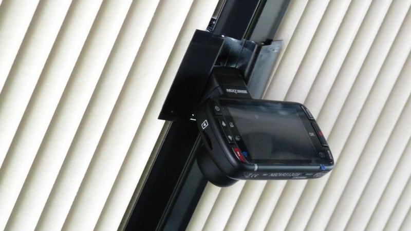

Our interior mirror (which was surplus anyway!) got knocked off the windscreen and rather than fix it back on I did this instead.
It's hard-wired into the fusebox at the drivers right knee. You do have to remove the cable from the mount but that, plus realigning the camera, only takes seconds.
Having said that, we've usually got our external screens on and, therefore, don't close the Reims blinds.

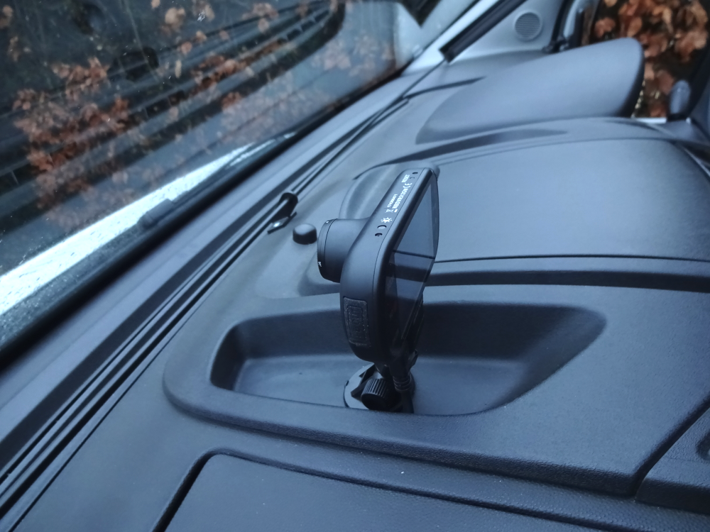

I had the same conundrum...
Tried attaching it to the top of the dash but the vibration was beyond belief. Kept setting the shock sensor off and locking every recording :D2
Even tried disabling it but the footage was unbearably shaky when watching it back.
In the end, with careful measuring, I found a gap not far up the windscreen that allows the blinds to still close.
With a caveat, you'll need to unclip the camera at night. That's all though, it takes about a second :)

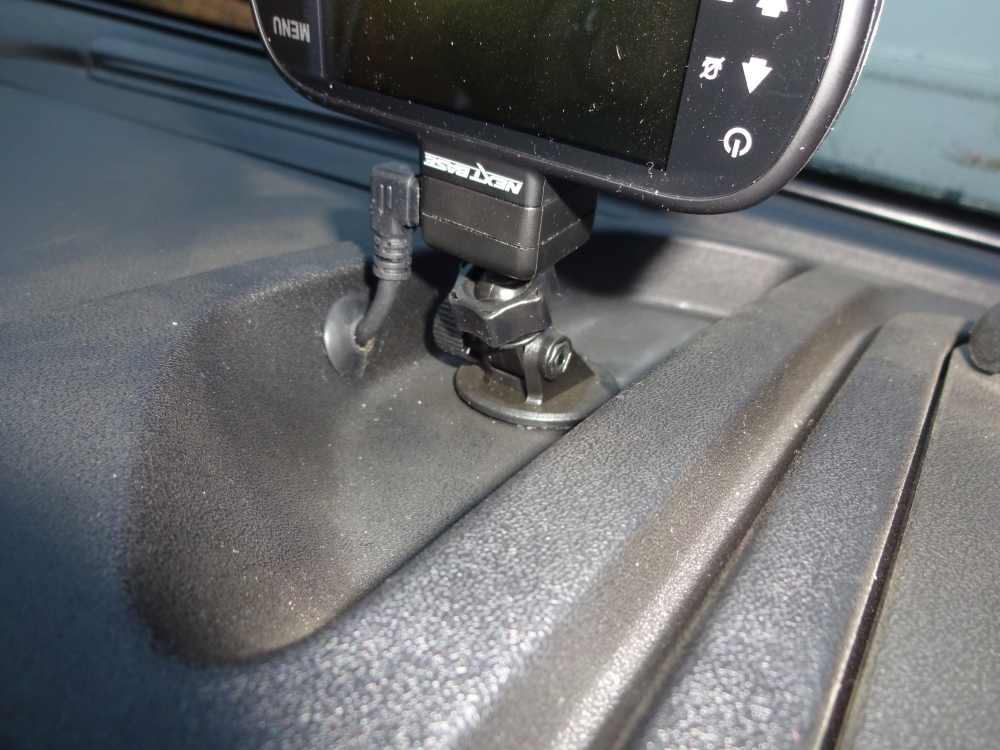

Nextbase 5xx model:
I tried mounting mine in a few places to avoid the blinds but found that I had to remove the camera which became a right PITA. In the end, I found that I could mount it at the bottom of the screen and blinds missed it
Cheers
Trevor
