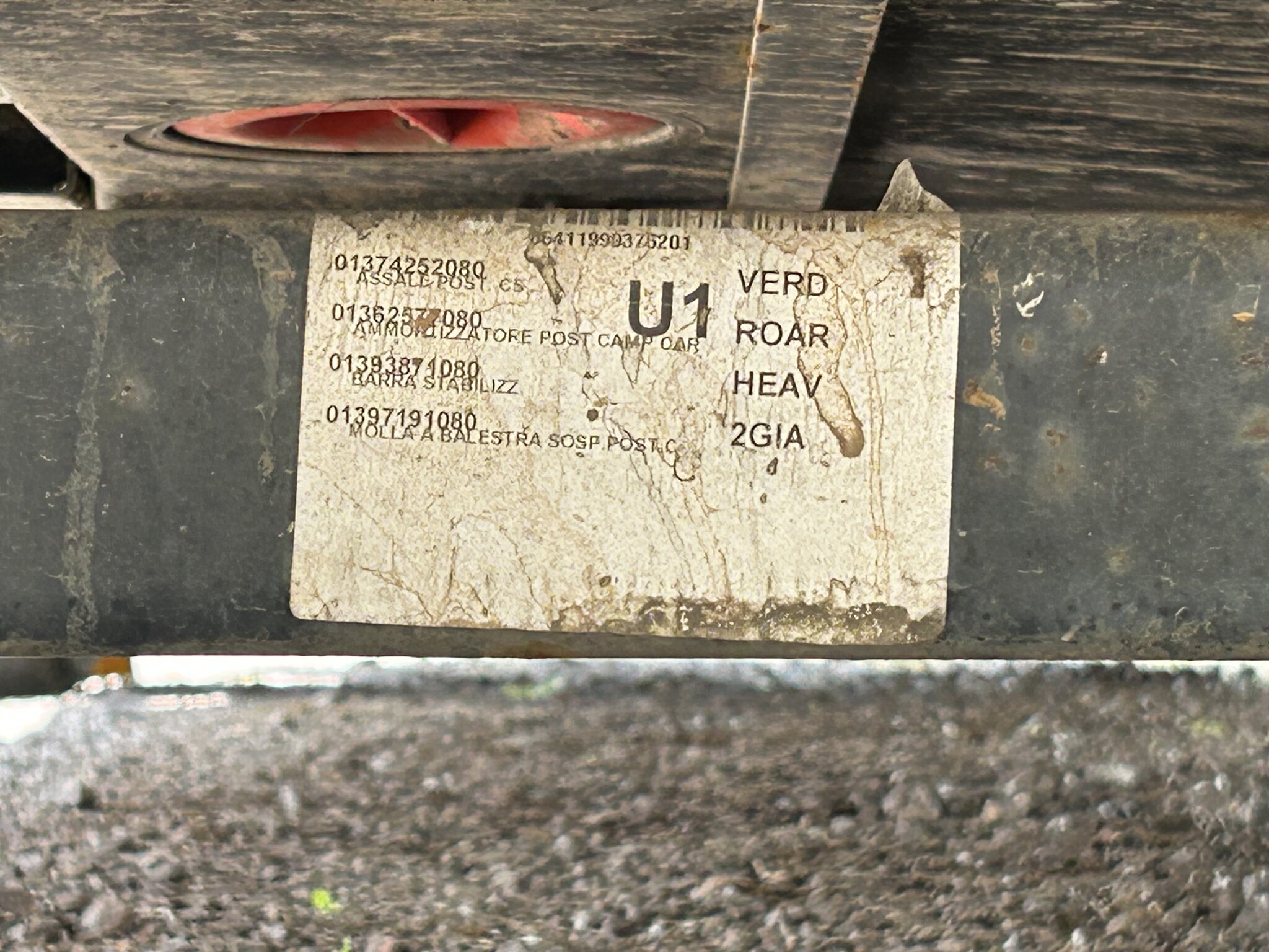

Checked today….it’s painted (black) so fiat
Fiat chassis are white so what you are looking at painted black will be chassis extentions, can't bolt a towbar to them.
Popped over and took these if it helps? 🤷🏻‍♀️
Was I looking at the axel?
You won’t need chassis extension, virtually no rear overhang. Looking at the photos a standard van towbar may fit.
