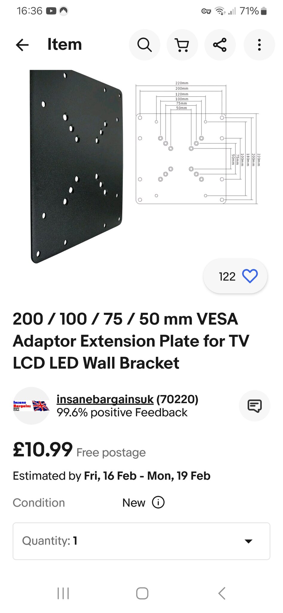

In our Burstner TD 700 we have an Avtex 24 inch tv, as the bracket is in a recess the tv would not mount, so I bought a VESA plate and fitted that off centre ( made a cardboard template first) , tv is easy to slide off the quick mount. Did this rather than move the existing bracket.

Can you supply a link to the bracket you ended up buying, yours looks like it's sitting out from the TV versus flush? I assume you needed to drill some of those holes yourself to get it lined up properly?

j8snl the swing bracket was factory fitted, the vesa plate is as the attached image. From memory I had to drill one , may be two , holes so that the plate could be offScreenshot_20240214_163603_eBay.jpgScreenshot_20240214_164116_Chrome.jpgset to receive the tv. My tv is on a vision plus quick release , so one part is fixed to the vesa plate
Perfect thanks Vanderek I have the same factory fitted swing bracket. I was curious how you "joined" the two had they been flush on the TV but I see now using the quick release which creates the cavity to join and offset the two brackets. I'll probably just use an M4 nylon standoff between TV and new bracket to allow a small gap for the nut and bolt to clear the TV attaching to the original mount.

Thanks again Vanderek bought that exact bracket you had. Just redrilled 4 new holes for TV and used the kit to mount to existing.
Actually didn’t need any standoff as didn’t realise the plate was countersunk so the head sits flush anyway 👍
