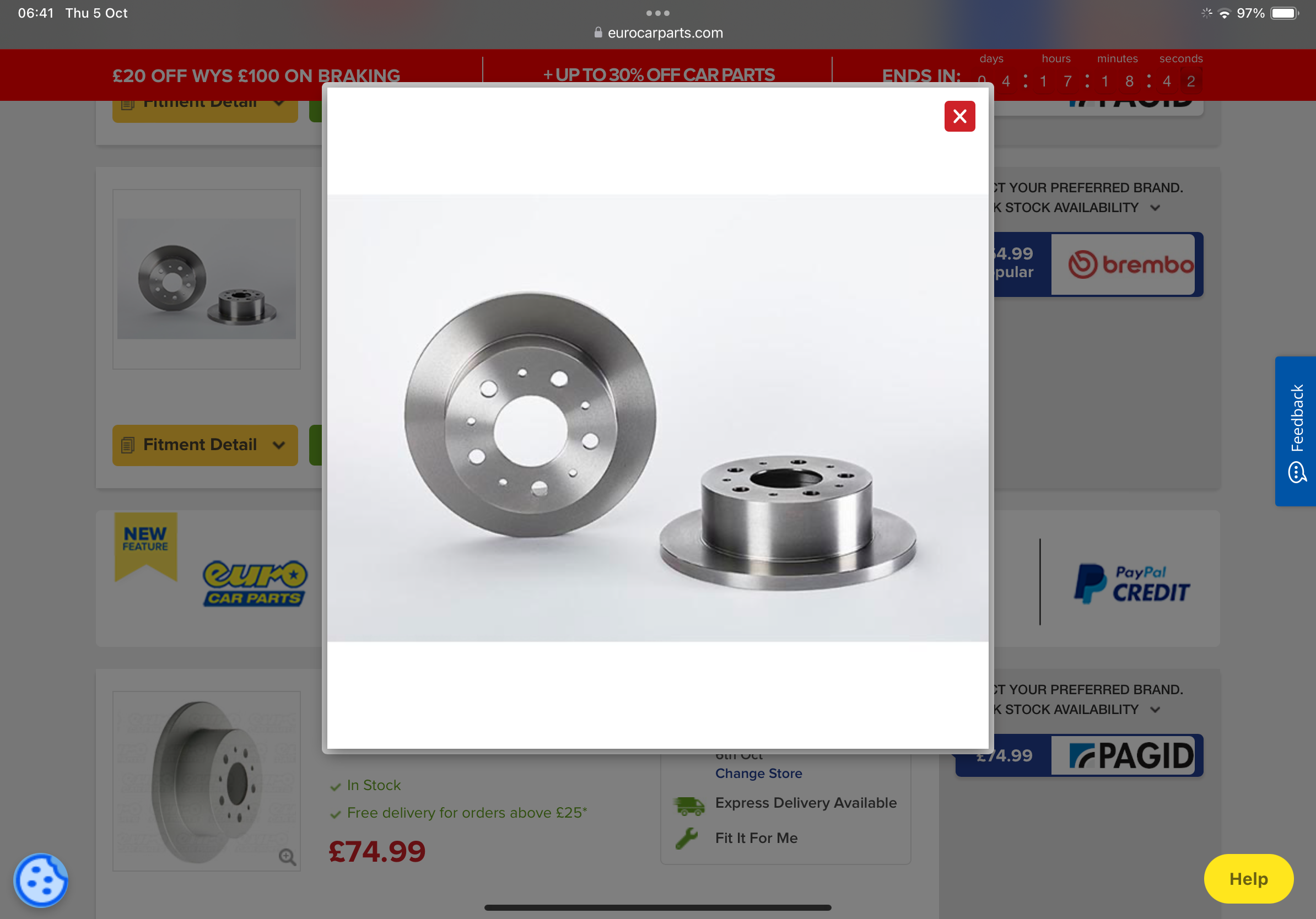

Heres the ones that fit my van, a 2006 Ducato but I have the Alko chassis, so not sure for your van, but put your reg number into here and it’ll give you an idea of what is available. Mine has what’s known as the top hat rear setup for the handbrake, but could well be different for yours.
My rear Brembo discs.
My front Brembo discs.
