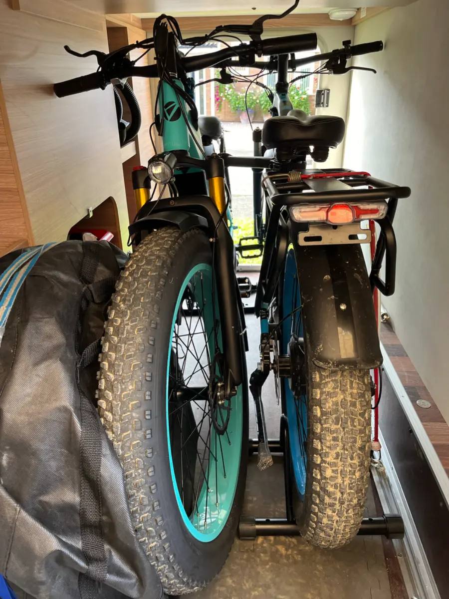

As posted on another thread, https://www.motorhomefun.co.uk/foru...ns-of-models-to-consider.313595/#post-6408896 we use 2 toast rack type supports that the rear wheels go into. They are adjustable for various width tyres, ours being 4" fat tyres. https://www.amazon.co.uk/dp/B0CFTDR9DB?tag=mhf04-21 & a plastic one that was chosen for low weight and to trial. We put the bikes in front to rear and use a decathlon https://www.decathlon.co.uk/p/bike-frame-adaptor-bar-for-bike-rack/_/R-p-328787 to join the 2 seat posts and basically create a solid box like structure so the bikes don't move. As each end has ratchets and quick release mechanisms it's easy to fit and remove. We then use a bungee on each pannier rack to secure to the eyelets in the garage floor rails. We do drop the handle bars more to quickly load than any other reason.
Cheap, simple, quick and easy to use.
