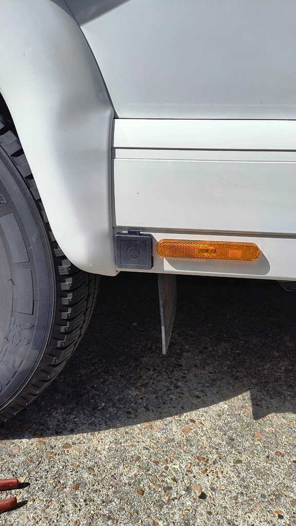

Here's a piture.

Thanks for your replies, I think I will have a measure up and set it out before drilling the dreaded 70mm hole! It will definitely not be in the door but on the side wall/panel.
