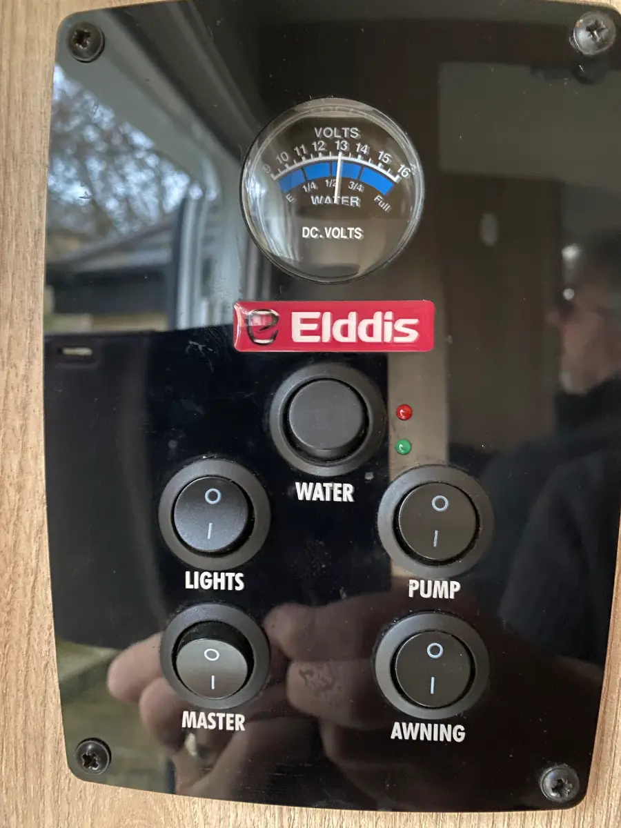

Is there such a thing as an accurate battery meter ?
I have these two meters neither of which instil great confidence in their accuracy. The Solar controller just gives you a green light when it's ok, flashing green when charging and an orange flashing when it's getting low and it doesn't even register the second battery. The Elddis is just the standard battery meter.
Is there a digital meter that would tell me how much I had left in both batteries ?
You can get digital voltmeters which plug into your cigarette lighter socket. Really cheap and will be accurate enough. I assume, like us, that you have a socket on the dashboard somewhere and a different one in the hab area which looks at the hab battery.

That's same as my control panel, the voltmeter isn't very accurate but the simple rocker switches are great 🤩

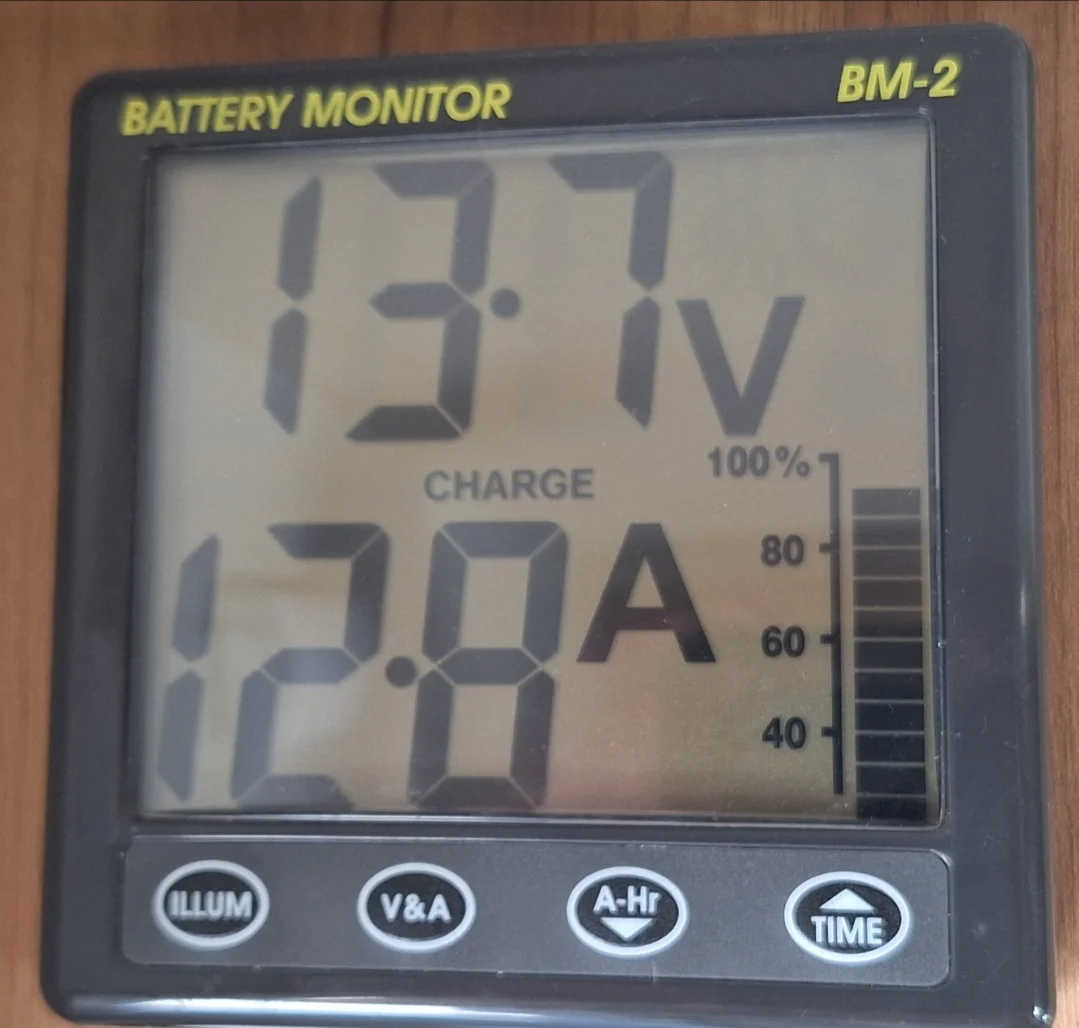

Anyway you need one of these, there is maybe room for it directly above the control panel. Gives lots of info with 4 different display options 👌

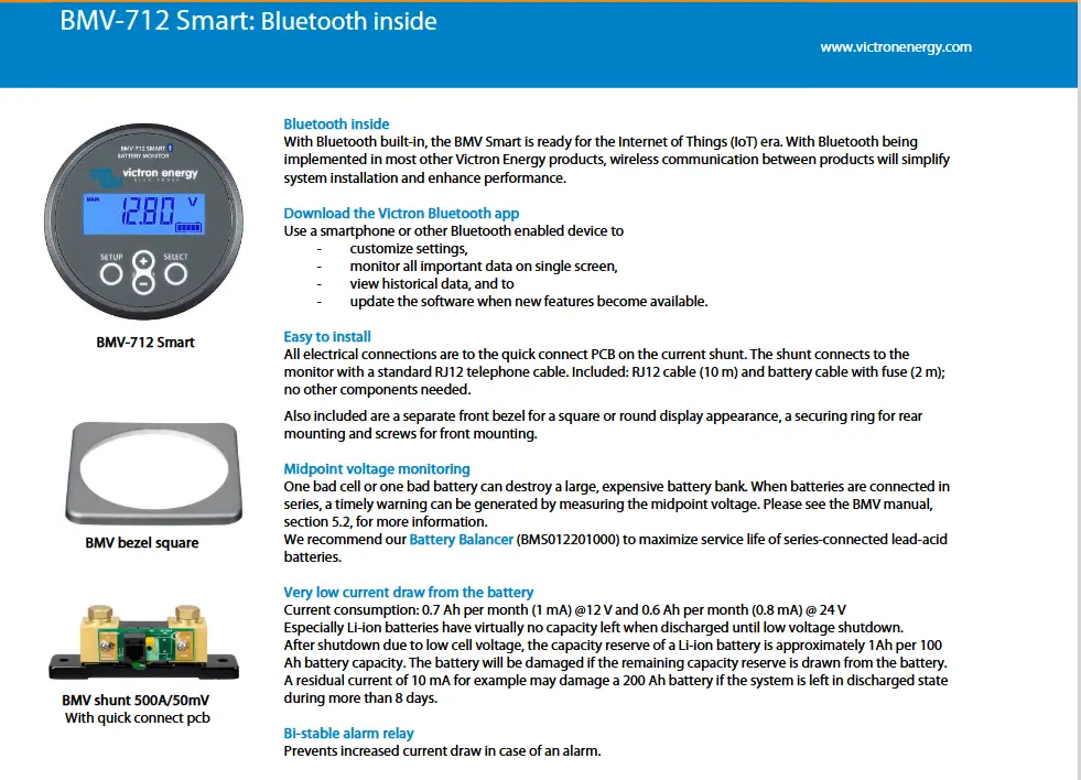

Yes, there are lots of options, including those aleady mentioned
and
Lithium Only
and
The two latter ones not using bluetooth.
