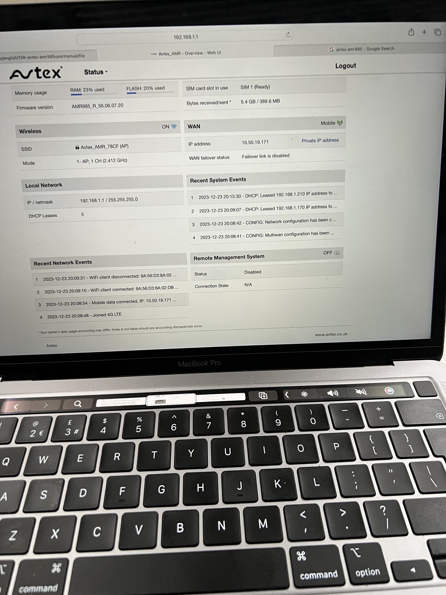

Hi all you teach wizards, looking to go into the main set up to change the provider as at present we are on Youigo which has a poor singnal in the area. How do I gain entry to the main operating system to change the provider? Thanks for you help.
Mark
I would have thought it picks this information up from the SIM being used? The modem is LTE so can't log on to anything else other than the network allowed by the SIM.

There should be a advanced menu screen Mark were you can change the network selection from auto to what you want see page 16 on attached manual.
Make sure your computer is connected to the Avtex router wifi.
Open a web browser (for example Firefox, Edge, Chrome or Safari)
Type 192.168.1.1 into the search bar.
The router login page should open. You will need the administrator user name and password.
That will very likely be printed on the label. Note that it's not the same as the the wifi SSID and password, it's entirely different.
If it's not printed on the label then there are other ways to find out. But try that first.
