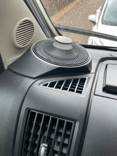

Well the Alpine dashboard speakers arrived today :happy:
Fitted within the hour. Very easy.
Whilst they’re not exactly cheap at £230, they totally transform the sound. The tweeters are no longer used and these act as a full range speaker bringing in some badly missing mid/highs.
I thoroughly recommend them before changing the door speakers.
That said, I would also change the door speakers, then add a subwoofer..... maybe some amplifiers...... make it all active with a DSP.. ahem! I digest! :rock::rock:

Dynamicsounds.co.uk
I think I may be one of the first in the UK to buy these as no-one had them that I could find. Dynamicsounds were able to get them from Alpine within two or three days though, very pleased with their service level and help. They now show them on their website.
All the parts you need are in the box, no need for any other connectors, just unplug the tweeter cable and re plug the new speaker back in.
The only slight negative is screwing them onto your dashboard, so they’re with the van for life should you ever change motorhomes, unless you carefully fill the small screw holes back in which I suppose wouldn’t be too difficult to do well.
Definitely worth it though. Nothing worse than a long journey and a bad stereo. These help drown out the missus :lipssealed:.

Many thanks again. I’ve since went and checked my MH and although a Fiat, as it’s an A Class the surrounds at either side of cab corners aren’t suited to these. So neatly ordered, as could have sworn it’s as were in picture you posted. Ah well, need to look at other options. As you say, need to have good sound to drown out sounds on long journeys....ssshh.
