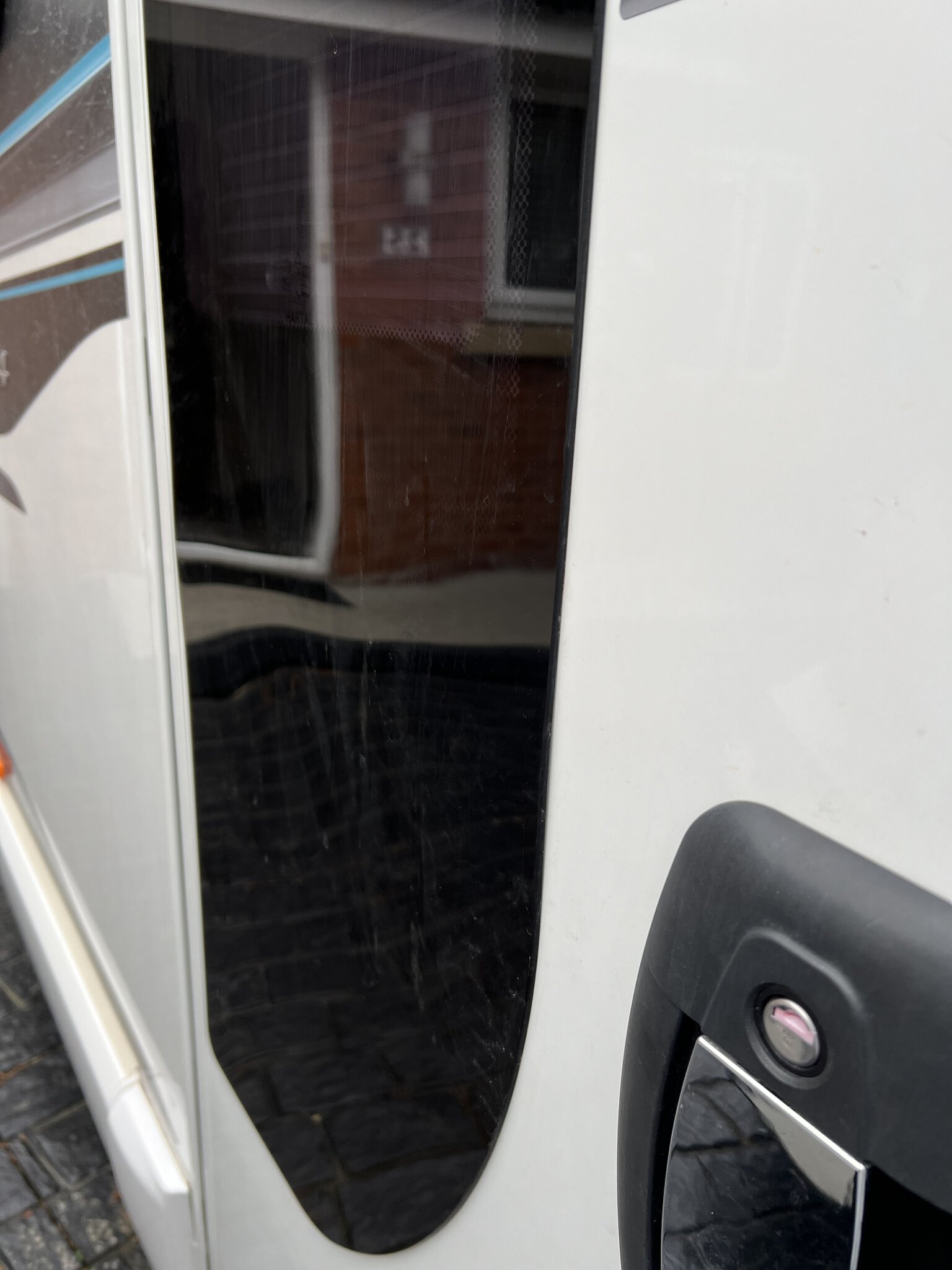

2, warped habitation Perspex glass, common fault!, awaiting glass

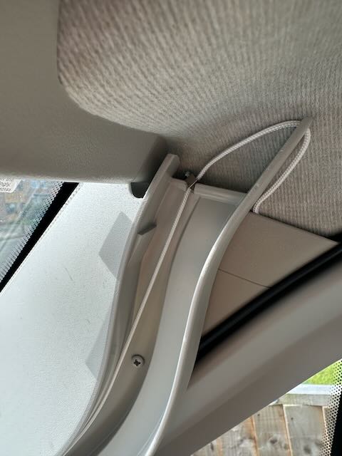

Here's photos of the creased blinds. When I got the van it was only creased on the left hand side, now they've kindly provided creases on both left and right. It's not the end of the world but they are clearly damaged and they pointed it out in the first place. You buy something of this value and expect everything to be as it should be when new. I wouldn't buy a new car and accept marks on the seats.
Heres the string/bolt combo holding the whole thing together as well. It comes off 9 times out of 10 when closing the blind.
During my heated conversation with the service desk I asked if I could get warranty work elsewhere. They said yes as long as it wasn't already logged with them. I've not had any experience with this though.

Your blind looks like it’s been stored with things sat in top of the blind that’s terrible.
The string needs threading behind the blind frame and pulling tight, the little metal lug then sits square behind the little cut out, this stops the lug flipping out when you lift the blind.
You need to hold the blind top bar solid as you close it, using two hands, then twist it to lock it.
