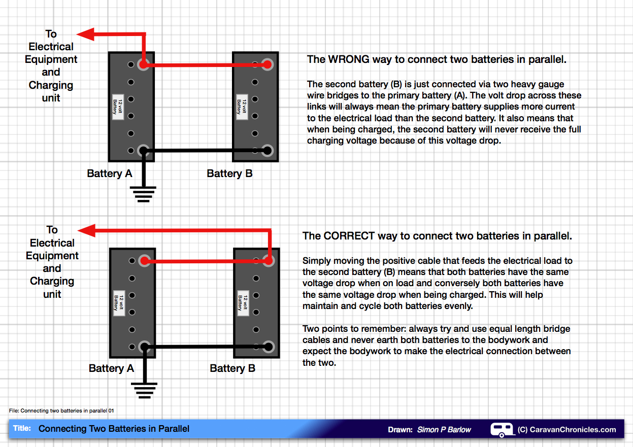

Ok, I think I have decided (eventually) to buy 2 of the Exide/Sonnenshein gel batteries and install them myself. I understand how to connect them in paralell but can you advise if I should be looking to put a fuse in between batteries? Should I charge each battery as a single battery first before connecting them together or is that not necessary with modern battery technology?
Thanks
No need for a fuse between batteries…😎
