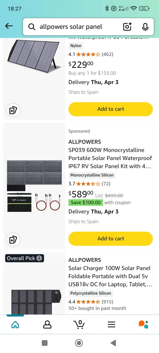

Has anyone used one of these? its 600w so more than enough under good conditions but might just be enough to pull in some power when conditions are not so good.

Thanks everyone. Looks like it's not really viable for me, but for anyone interested there is one advertised on Facebook for £250.
