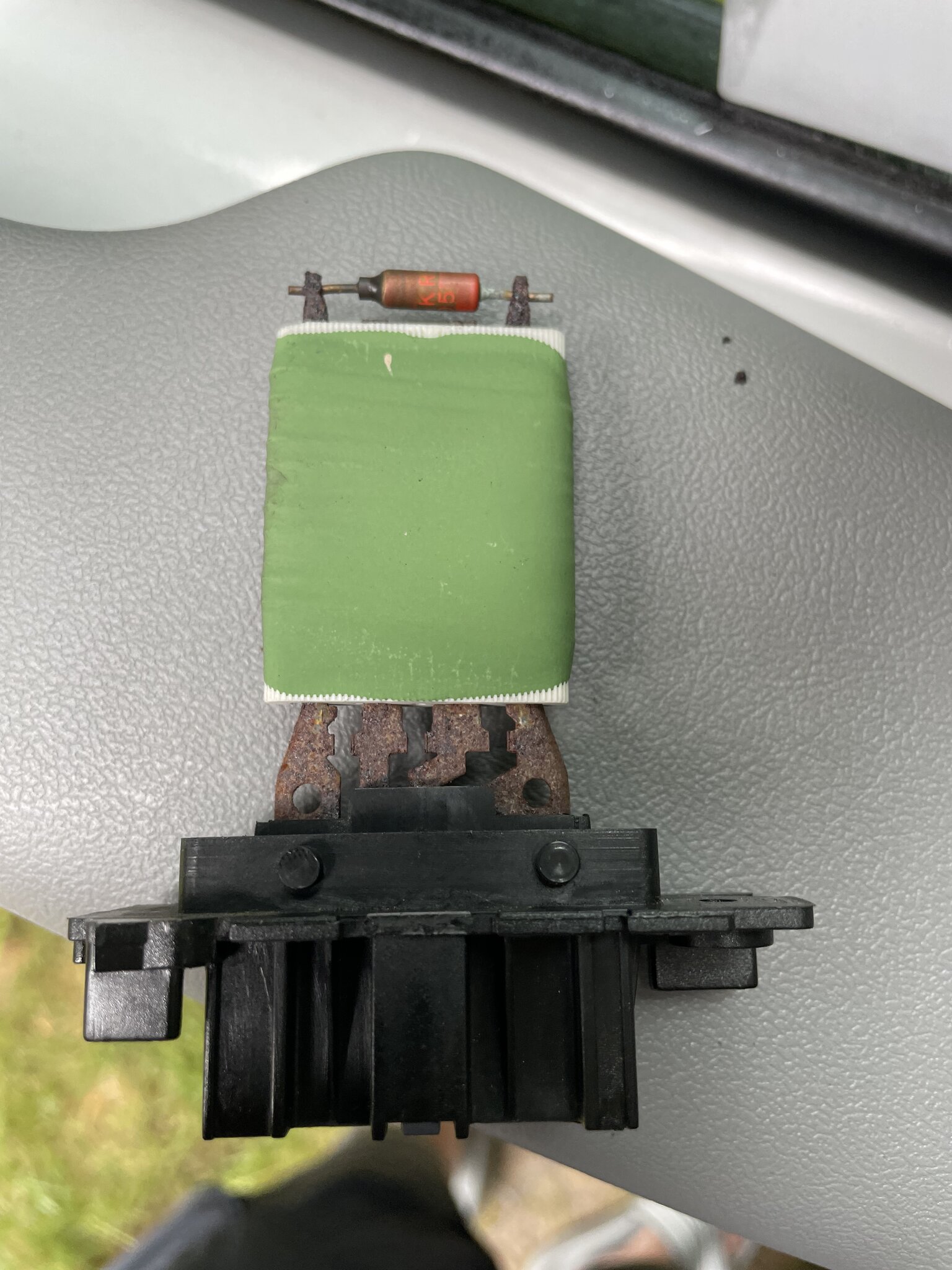

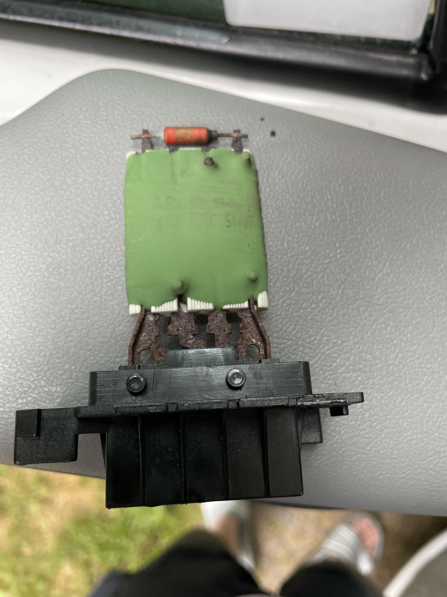

So, I managed to find a YouTube film if a guy changing his resistor (maybe the same as above) and easily removed the old to ensure I was ordering the correct one.
£12 on Amazon and the plan is my wife will bring it with her to Spain when they fly out.
Looking at it, it looks like it’s been in water for 5 years!

The resistor sits in the airstream of the blower. It probably gets blasted with pretty humid air quite a bit. So yeah, it gets pretty crusty.
What does the connector and wiring loom look like? Are there any obvious hot spots or melty bits? Both times mine died, the failing resistor melted the connector.
They looked ok.
Time will tell I suppose
