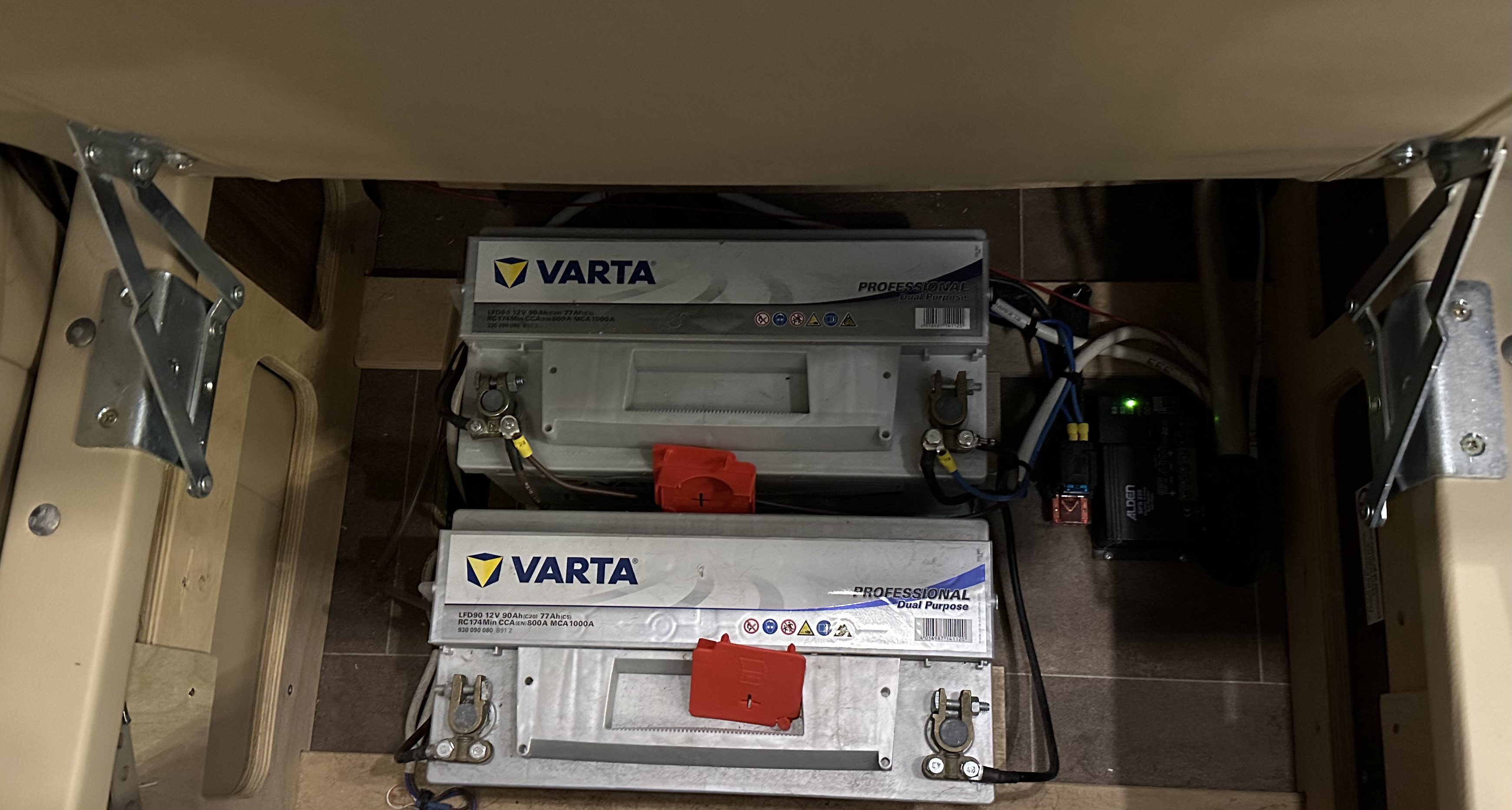

I have replaced the starter battery (like yoga with weights) and have now moved onto the hab batteries….. and I’m investigating a swap to Lithium. Our van is a 2014 Burstner Elegance, currently fitted with 2 habitation batteries (lead acid Varna 90Ah batteries) and 140w of solar (I think).
I have been looking at the Fogstar Drify, with a single 230Ah or 280Ah battery replacing the two existing.
Our current system includes a Scahudt 220-4 with an independent Alden SPS220 (with a LiFePo setting). We don’t currently have an inverter, but I am considering one.

I have almost exactly the same. 2014 Elegance with 2x varta 90amp leads. Solar controller is the Votronic that also has a lithium profile.
A few week ago I bought 2 x Ecoworthy 100amp lithiums off a guy who upgraded to a larger home battery system.
From info off here and direct from Schaudt it seems the EBL is ok left on Lead gel setting, swop solar to the lithium battery. Like you I want to do it in easy stages. So plan to just swop the batteries with the charging as above.
Long term I will go with a B2B and a battery monitor as the Ecoworthy does not have one built in.

For the EBL 220 it is very easy to disable the split charge relay when you want to fit a B2B. The split charge relay is built into the EBL220. The supply to it comes from the starter battery, through a 60A fuse next to the starter battery. If you remove that 60A fuse, the split charge relay will be isolated. It will still click on and off when the engine starts and stops, but it won't do anything.
The other functions like fridge power on 12V while driving, and starter battery trickle-charging while plugged into a hookup, all go via a second wire through a 20A fuse to the starter battery, so will not be affected by pulling the 60A fuse.
The EBL220 has a battery type selection switch (Batterie Wahl) and you can choose flooded lead-acid (Blei-Saure) or Gel (Blei-Gel). I think of those two it's best to choose flooded lead-acid, not Gel. I know some people recommend Gel, but I think that's because most EBLs have a choice of AGM and Gel, and the Gel setting is better than AGM. For this EBL, the lead-acid setting is better because it doesn't have the extended timed absorption stage at the higher voltage level.

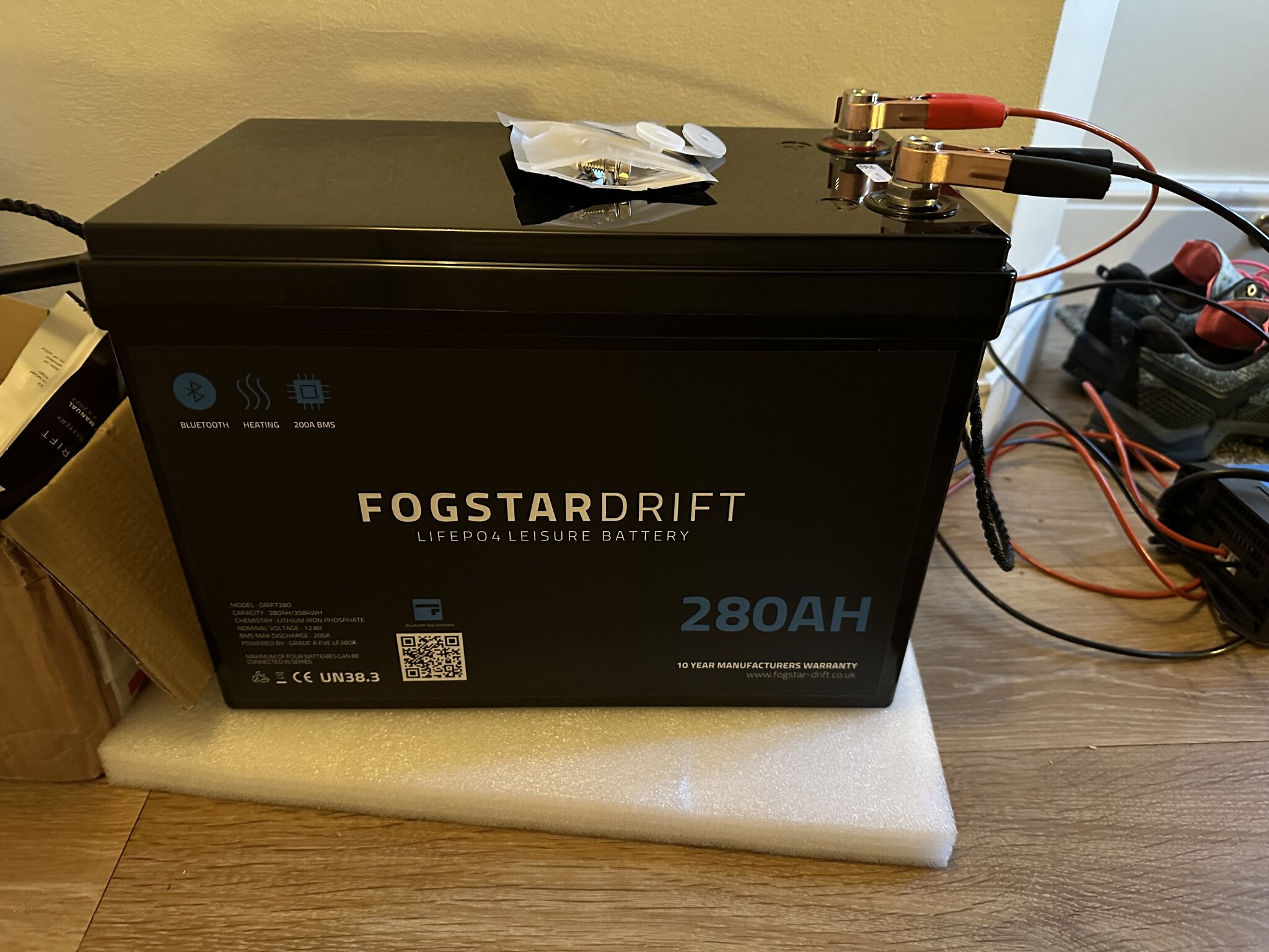

Well. Today was the day. A nice man from UPS delivered a Fogstar 280ah battery, victron 100/20 solar controller and a smart shunt. Supplied by Offgrid Power Solutions (complete with the funster discount). B2B charger to follow next month.
Install starts tomorrow.
