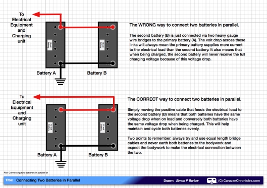

Two matched batteries joined red to red and black to black will behave like one big battery. Add a Battery Master and surplus charge goes to engine battery)just two small wires).
There are right and wrong ways to connect up 2 batteries
