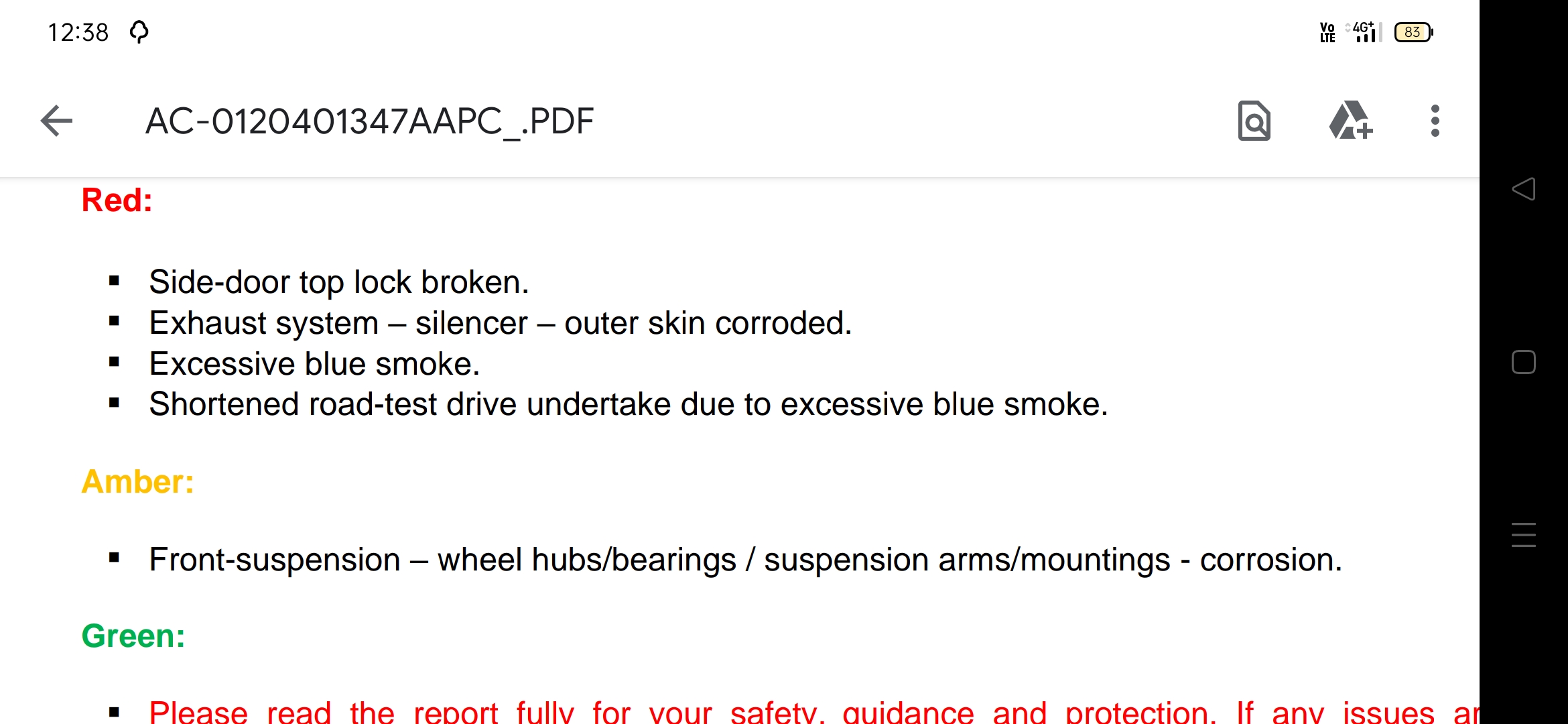

Hi all. I need a bit of advice if anyone has any. I'm close to buying a 2012 Rapido after agreeing a price I'm happy with. I just had the results of the AA inspection. Can anyone please share they're thoughts on this? I'd be really grateful. For the experts out there, what would you do?
The 'excessive' smoke doesn't sound good and usually points to a very worn engine, especially as it necessitated a shortened road test. Blue smoke is usually from engine oil. Diesel fuel smoke is black.
Suspension mountings corrosion could be expensive.

I wouldn’t touch a van that was offered for sale with “excessive” blue smoke coming out of the back…and (I’m assuming from the initial post) no explanation from the seller.
At the very least I would expect them to have diagnosed the problem and cost of the fix so you could make a suitable deduction from the market value
Blue smoke is normally a sign of oil being burnt.
Black smoke is diesel related.
Any excessive smoke needs further investigation.

Oil burning on a motorhome is going to be an expensive fix. Commonplace on vans left idling to charge up batteries.
Plenty of good ones for the sort of money a 2012 van will be costing you. Go find another one that doesn’t have such a major issue.

Blue/gray exhaust smoke means there's likely an oil leak and your engine is burning oil. Time to have a qualified technician check things out. The leak could be caused by several issues like leaking valve seals, damaged piston rings, or worn cylinder walls.

I’d be surprised if it was burning oil, if I’m being honest. They are robust engines, and normally motorhome ones get an easy life. I’m not a believer in the ability of AA people, so dubious about his report, and what he classes as excessive and corrosion. Neather are things I would expect from a 2012 motorhome.

If it's a Fiat engine of that era, we had one that smoked under warranty. It turned out to be a faulty DPF(?) sensor. No idea what it cost to replace but no issues afterwards. From memory, it only smoked when decelerating, not under load.
Could be many things leading to blue smoke. As above, it is oil being burnt. It may be worn piston rings, valve guides, turbocharger, oil collected in intercooler, even a cracked piston or cylinder head.
The first simple thing is to check the oil level is not too high, by a lot that is. Check the cylinder compression to determine worn piston rings. One trick is to disconnect pipe from interchange to inlet manifold and run the motor, not at full power, to recheck smoke which will take any turbocharger seal leak out the question. Done carefully to ensure no debris can enter manifold and to be aware turbo will still blow air through the intercooler.

Wow. Such a helpful place. Thanks for all the replies. There seems to be a consensus that it would be better for me to leave it. Have to say I'm a little gutted about it. Previous MOTs had nothing other than a few tyre advisories and Anti-roll bar linkage pin or bush worn. The rest of the extensive AA inspection was all fine and I'm happy enough with the inside. No damp etc. 2012, base Fiat Ducato vehicle, 50k on the clock.
My knowledge of engines etc is severely lacking which is why I got AA to look at it. Like I said, I feel a bit gutted. Thanks a lot for taking the time to respond 👍
