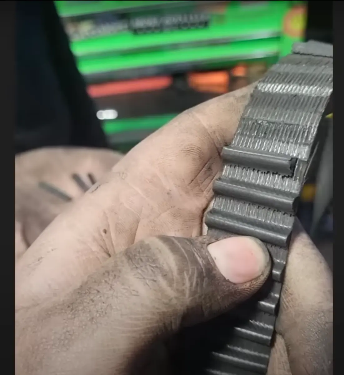

Not mine, but from a Skoda Yeti, which believe it or not was still running, but came in for a belt replacement just in time.
