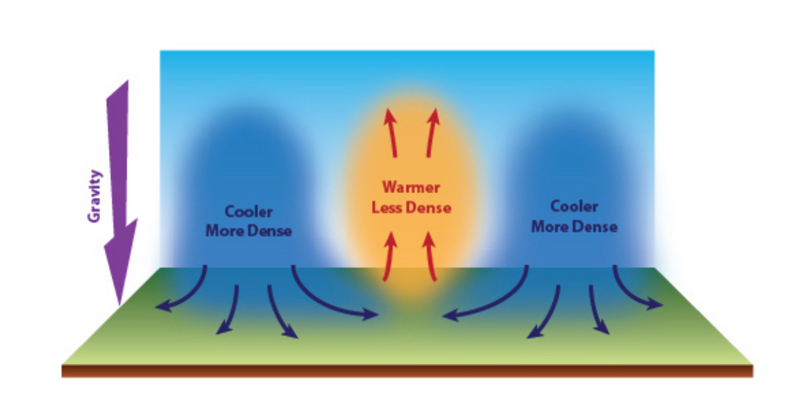

There is a guy called Jason on Hymer club UK on Facebook, he installed a 12v system and claims it's good but his vents are at floor level so I'm not sure how effective an arrangement that is ?
It will be better than trying to pump it from above - EuroTrotters i think is the expert who will confirm.
