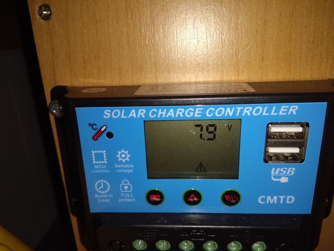

I looked into the cupboard this morning, to try and see if the solar is working. But I have no idea if it is or not, and the solar controller has a usb socket, but it wasn't able to charge my phone. The reading is 7.9. No lights on it so don't know if it is charging or not. My friend is getting some charge into his van, so should be the same on mine.
I am confused, and hoping someone can give me some clues before I start ringing Marquis and the caravan engineer. I don't have a lot of time either, as I am booked on the Santander Ferry on 28th October.
I have taken some photos of the solar controller, in case it helps.
I don't know if 7.9volts is coming from your solar or is your leisure battery state but neither is good, if you have a multimeter check the voltage from the solar panels as they go into your controller, you should be seeing something around 18volts.

Sorry, i don't have a multi meter. Maybe I should invest in one, although I am a bit scared of electrickery.

A few minutes, or even hours, of hookup or engine running has not charged your batteries, what you are seeing is the charging source voltage not the battery voltage.
At 7 volts your batteries are beyond charging and need replacing once the reason has been found for them not being charged.
The voltage across the battery terminals is not a very good indication of the state of charge. In many cases it can be totally misleading.
For example, when a very flat battery is connected to a charger (or solar panel), the charger will raise the voltage to 13 Volts almost immediately, even though obviously it needs charging for several hours more to get it to the 100% charged state.
The battery voltage is only an accurate indication of charge state if the battery is disconnected from everything completely, as if it was on a test bench. Even then, you have to wait about an hour for the voltage to settle down to its final state.
The red/yellow/green leds are simply a crude voltage indication, and are no substitute for a proper 'battery monitor', which is constantly counting the charge going in and out, and showing the percentage remaining.
