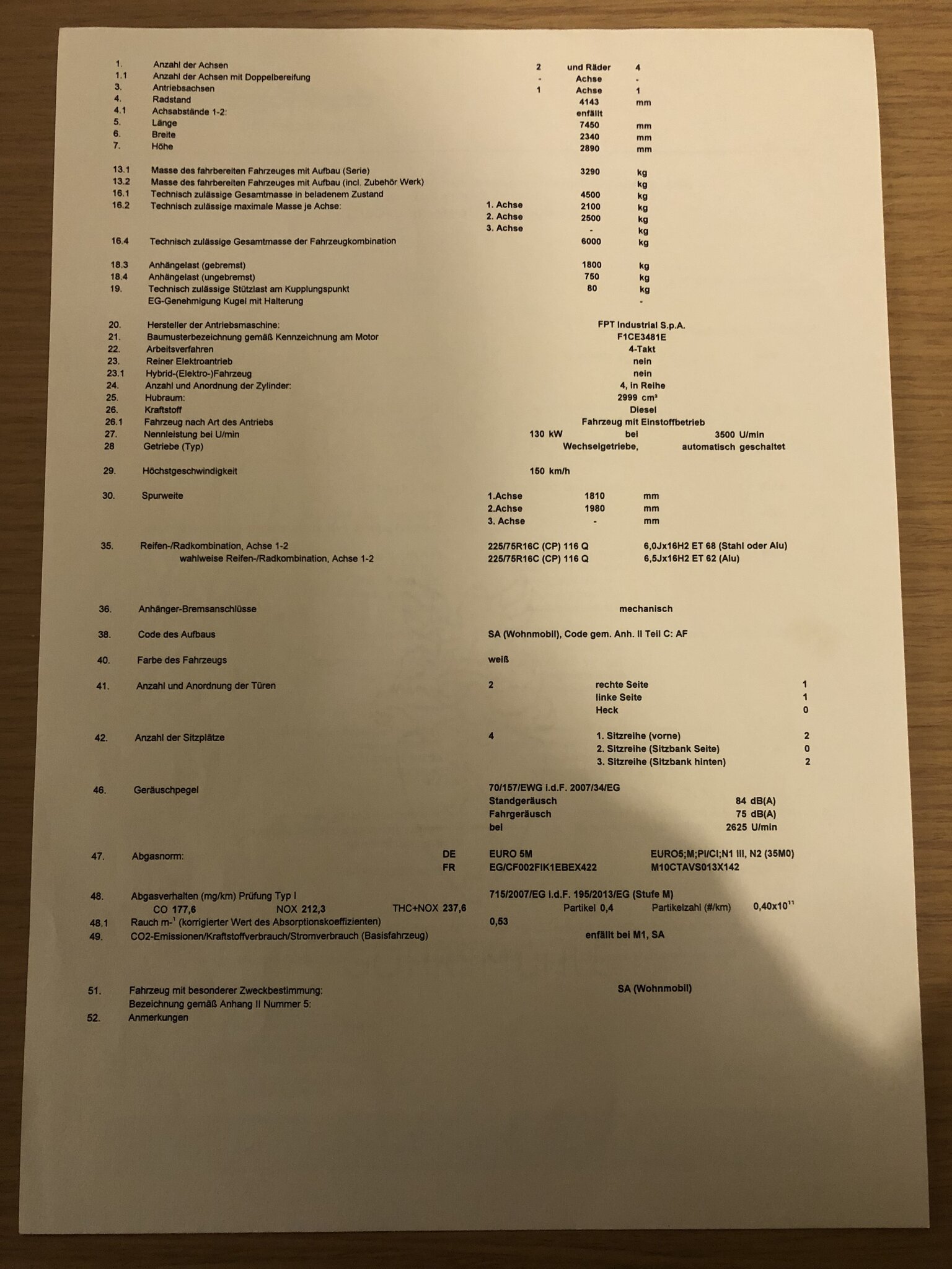

I wouldn't expect them to be there are quite a few variations on the Fiat wheels only way to know is find the part number on them.
It was the wheel of choice (before the new fiat wheels came out) on most chic C and E lines and Liners for two with most of them running 2500 rear axle (2 axle Alko)👍
